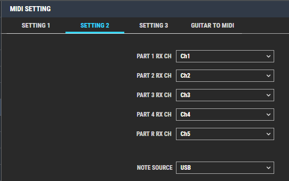

keitht
With these midi settings I can record six channel mono midi from the VG-99 and then play the midi back through the GM-800 with one string/channel for each part. There are only five parts and one is restricted to rhythm tones but this does work with some limitations.
strudl
If I understand well, this setting will playback 4 of the 6 strings(channels) recorded. That way you also have to set all 4 tones to same sound for playback and use another pass for the last two strings.
I cannot figure out a way of using this workflow to record and reproduce a midi performance where for example strings 5-6 are using tone 1 with bass sound and the 4 other strings would use a piano sound.
That's using 2 tones. The matrix becomes quite heavy if you use 4 tones and a mixture of strings on each one.
I guess I understand the limitations. Having external midi control is already a big step forward in the Gm-800. The internal architecture is really powerful, that's 6 instances of the same sound for each tone, one per string-channel. Meaning 4 tones uses 24 instances. This comes with limitation on reproducing all this from the MIDI IN.
Reproducing this in a Daw get me dizzy.
