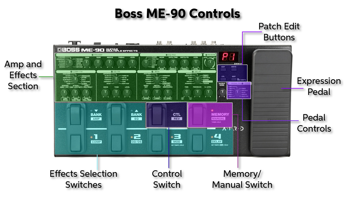

The occupied area is about 1.5 times the length of A4 paper. It has a moderately easy-to-use size, but it does not fit in the pocket of a guitar case, so a separate case is required for transportation. The body weight of 2.9 kg is slightly lighter than the average adult cat. It's lightweight, but the outer shell is made of metal, making it fairly sturdy.
And the latest "ME-90" that appeared this time is a simple and intuitive control system centered on knob operation, and high sound quality inherited from the flagship model. It is finished as a deep-pocketed multi-effector that can be used by players.
Sound creation can be completed simply by operating the knobs.
Knobs and switches lined up neatly. The assigned function is described on each, so it is difficult to get lost in operation.
The main advantages of the ME-90 are the simplicity and speed with which you can instantly adjust the tone by reaching out and adjusting the knobs . The knobs are set up for each function, similar to the state of a compact effector, eliminating the need to call up parameters or select operations from the menu. Even people who are not good at LCD screens can intuitively make sound. In addition, the colorful LED lets you know at a glance whether the effect is on or off.
There are 9 preset banks with 4 preset sounds. You can save up to 36 sounds, 4 each in 9 user banks, and easily recall them.
8 Pedal Switches and Expression pedal
BOSS ME-90 Guitar Multiple Effects | Introducing the most advanced ME model
You can use various sounds with one unit and switch at once.
While playing, operate the 8 pedal switches and the rightmost expression pedal. There are two ways to switch tones: "MEMORY mode", which switches by patch, and "MANUAL mode", which switches effects on and off individually. Use the [MEMORY/MANUAL] pedal to switch.
"MEMORY mode" that changes the tone at once
BANK selects read-only "preset banks (1 to 9)" and freely writable "user banks (1 to 9)" in order. The sounds of the selected BANK are assigned to numbers 1 to 4 in the foreground. The effect of the [CTL] pedal depends on your ideas.
In "MEMORY mode", operate the "BANK▼/BANK▲" pedals to select a bank of factory presets or user presets, and select and use patches assigned to pedal switches 1 through 4. .
You can freely set and save the sounds you create in the user bank, so you can line up four similar sounds or line up completely different sounds. Also, by using the [CTL (control)] pedal, you can set different settings for each patch.
"MANUAL mode" to operate effects individually
All effects can be turned ON/OFF.
The pedal switches in "MANUAL mode" are ON/OFF for each effect. MOD" and "DELAY" are assigned. Depending on the system settings, the [REV] switch can be used to turn the send/return ON/OFF, but in this case the reverb ON/OFF is blocked.
An expression pedal that expands the range of expression
An expression pedal that is larger than the previous model and has improved operability.
The expression pedal on the right side of the main unit normally functions as a volume pedal. If you step on the toe so that you can write your weight on it, the pedal effect will activate, and you can get various effects such as wah and bend.

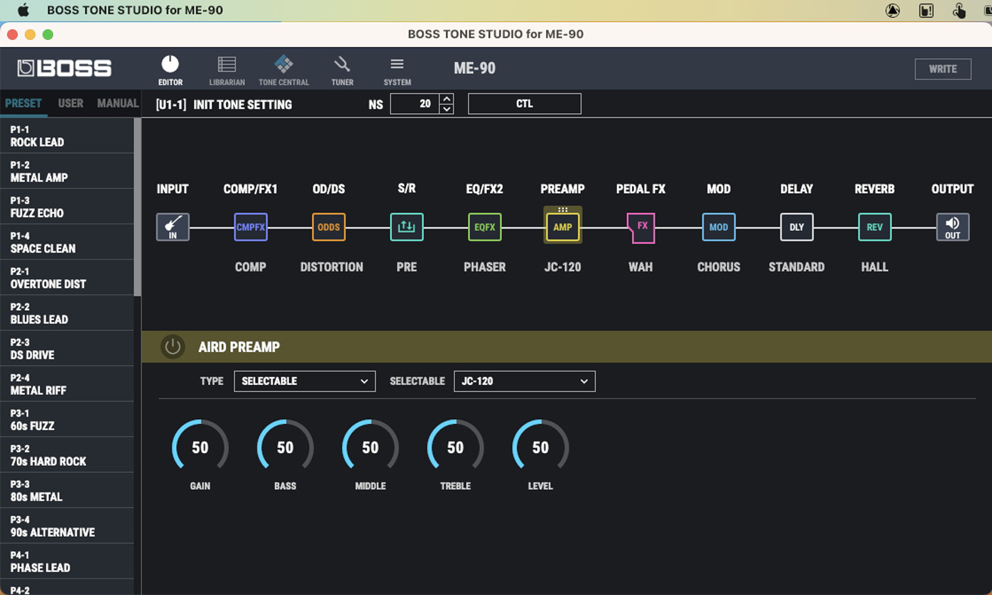

<<Reference>> Preamps and effects that can be used via the app
(Selectable) Through the dedicated apps "BOSS TONE STUDIO for ME-90 (Windows/Mac)" and "BTS for ME-90 (iOS/Android)", you will be able to select preamps and effectors that cannot be selected on the main unit alone. This is done by exchanging with a specific preamp/effector, but since the exchange is done on a patch-by-patch basis, virtually all preamps and effects can be used.
"AIRD preamplifier" inherited from the top model
The preamps included in the ME-90 are 11 types carefully selected from the top model "GT-1000". It has a good balance from clean to high gain, and models famous guitar amps, so it can handle a wide range of sounds.

The connection order of the effects is basically this arrangement, but the order is automatically changed depending on which effect type of each block is selected. For SEND/RETURN, the stage before or after PREAMP can be selected arbitrarily.

In addition, by using the dedicated apps "BOSS TONE STUDIO for ME-90 (Windows/Mac)" and "BTS for ME-90 (iOS/Android)", you can edit effects, use additional effects, save settings, etc. Deep usage is possible. Through this app, you can download tones created by professional musicians from the web library " BOSS TONE CENTRAL " free of charge, and you can also share live sets with other users on the online platform " BOSS TONE EXCHANGE ".
In addition to this, external IR data can be loaded with the dedicated application "ME-90 IR Loader (Windows/Mac)" when connected to a PC via USB, and can be used as an audio interface in conjunction with a DAW environment.
