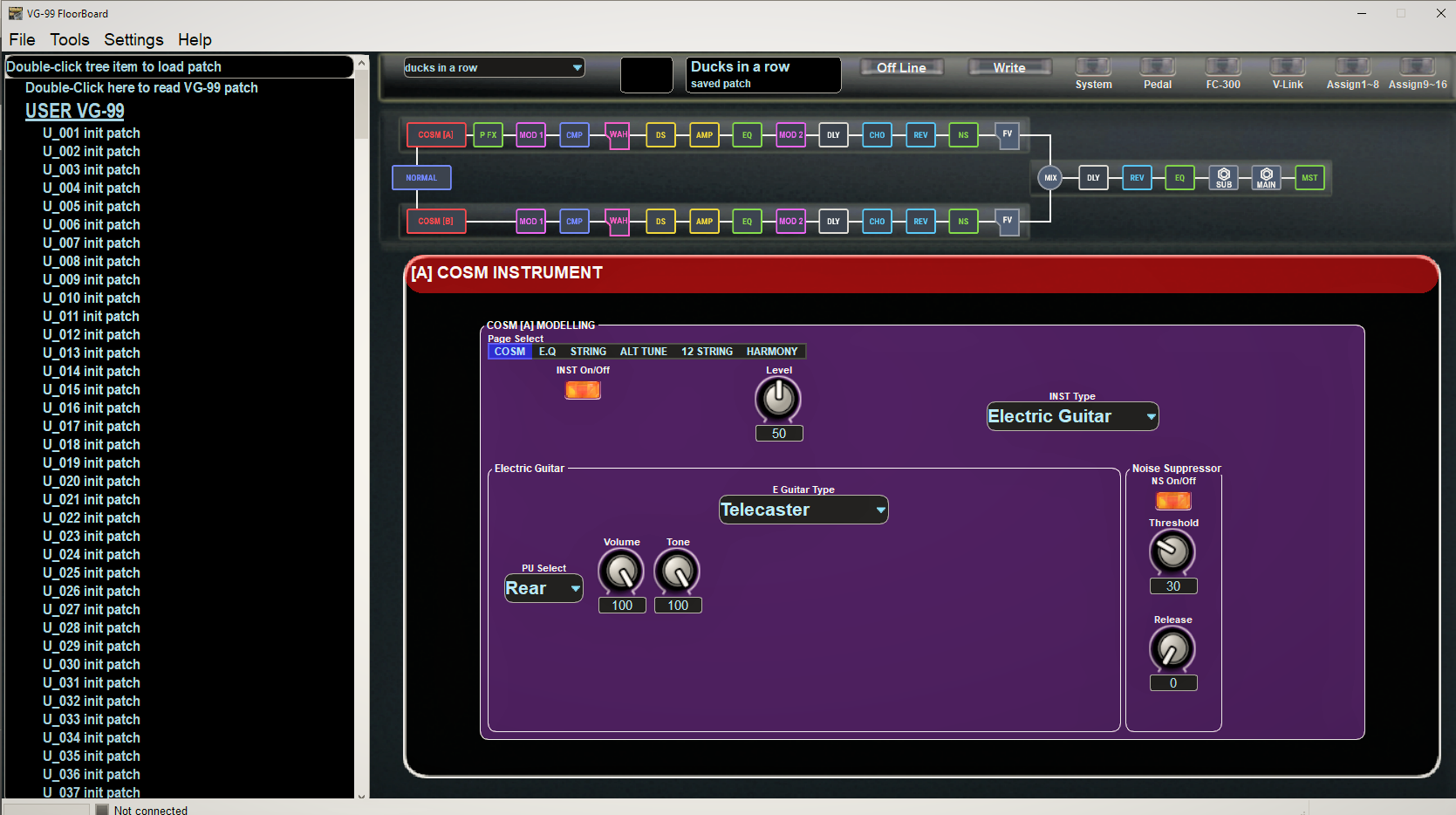

Not sure if this will be of help, maybe,
try using VG-99FxFloorBoard editor.
It is less visually confusing than the Roland VG-99 editor, and shows your signal routing very simply in a logical flow.
Download link here:
https://sourceforge.net/projects/sy1000floorboard/files/VG99FloorBoard/
IMH1234
I would disconnect the VG99 from all computers, editors, footswitches and the like and create a minimal init patch in the hardware - just any guitar model on the A channel, default model settings, turn off the all the various alt tunings, poly FX, amp, FX, or master settings. Just modelled signal to the A output. The B channel should be completely off. This will hopefully be a vanilla sound without any pitch or tuning changes and should sound as expected. Then go into the alt tuning section and turn on the Alt tuning mode - what happens? If you are now hearing the other strings as well as the expected tuning change check every other alt tuning type is off - most likely culprit I can think for what you are describing of is 12 string mode is also enabled. If that doesn't work, systematically go through every menu checking everything is off until you hit something that stops this happening - pay particular attention to any controller assign settings - these can easily create weirdness and be hard to track down. You will eventually isolate this at which point it should be straightforward to fix in every patch impacted
IMH1234
Also, make sure nothing is plugged into the external input to ensure this cannot be the source of the problem
