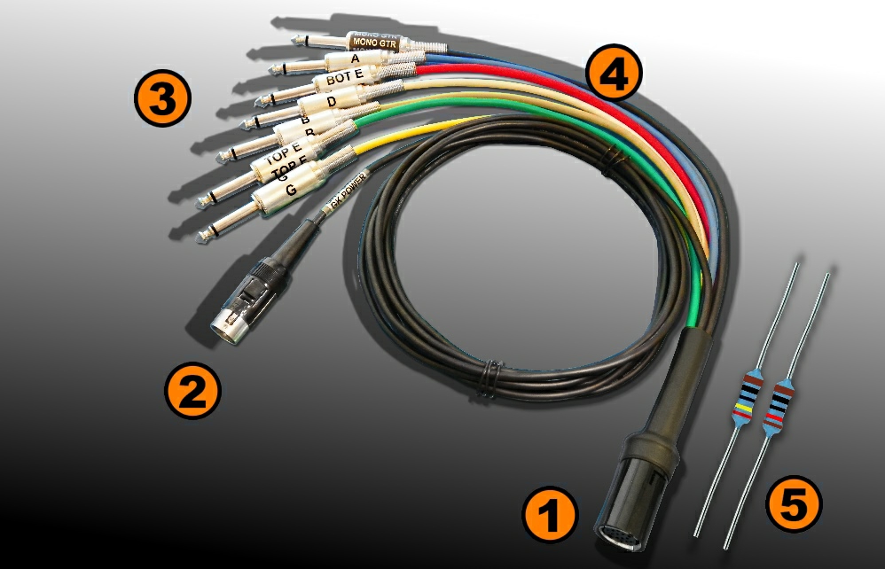

QuoteIn 2023, the Boss GKC-AD has one purpose- to provide a TRS SERIAL GK digital signal to a Boss GM-800.
Its not clear from your post you are employing a GM-800
Well, now in late 2023, I formally declare that the Boss GKC-AD has more than one purpose. In this setup, I am not employing a GM-800 at all. I only use the GKC-AD to provide power through the breakout cable to the 13-pin input on the guitar. ie. Connect the GKC-AD's female "GK In" port to the breakout cable's male 13-pin GK Preamp Power Connector that is labeled, well, it's labeled "GK Power". Don't connect anything to the GKC-AD's "Guitar out" nor its "GK out".
