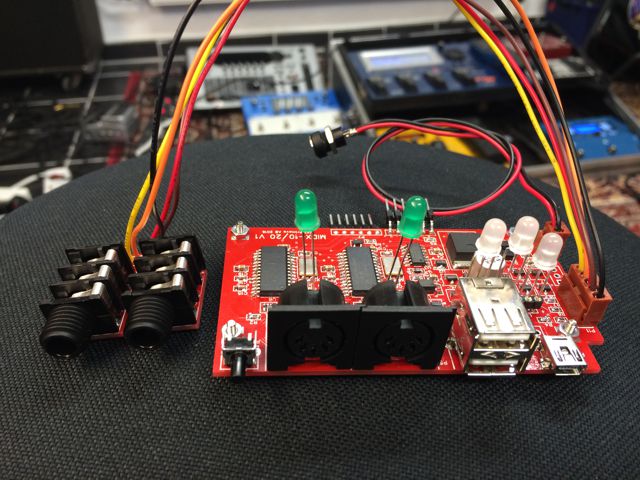

I have now developed a new MIDX board which will be sent to production.
Using the same physical board, a MIDX-10 or MIDX-20 can be realized
- The MIDX-10 is as before, a Roland/Boss compatible single USB to MIDI bidirectional converter. Nothing more/nothing less.
- The MIDX-20 is a further enhanced version with an extra processor and a special two-jack interface board (and yes a bit more expensive due to more hardware and more things to assemble/test).
The MIDX-20 has two processors each operating as a Standard USB or Roland/Boss compatible USB Host and the processors communicate over a high speed serial link, bringing them together as two tight work horses.
The MIDX-20 has two USB connectors  + 5-pin MIDI IN/MIDI OUT + two extra EXPR/CTRL jacks  :o

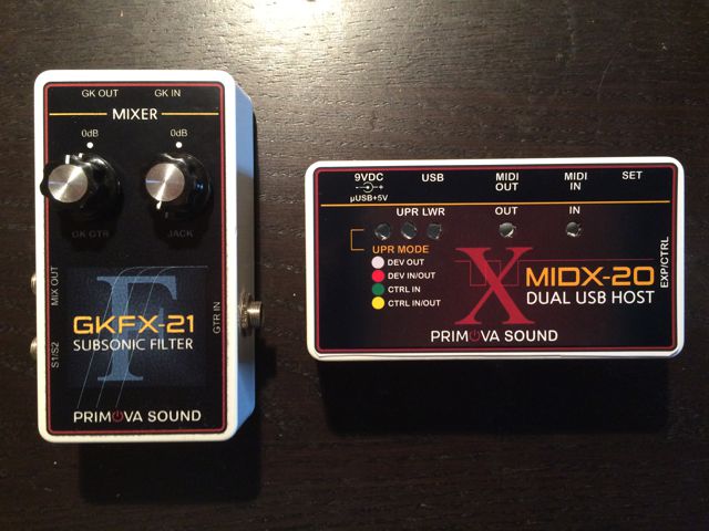

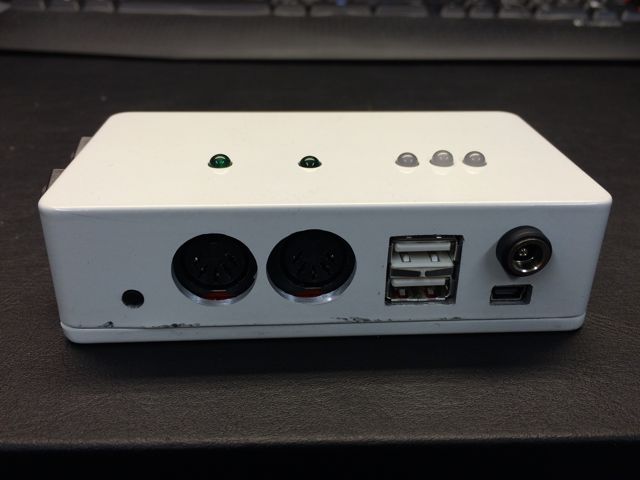

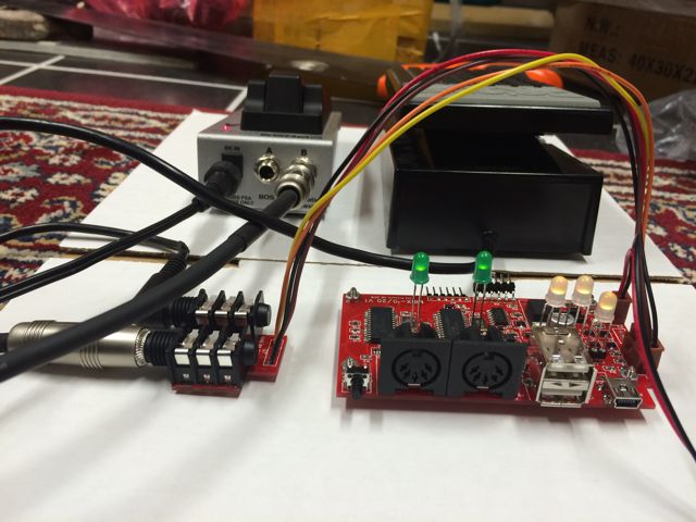

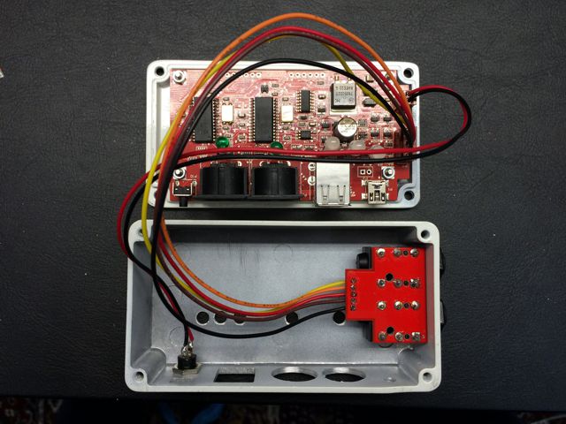

Here you can see the dual USB connector and the dual stereo jacks.

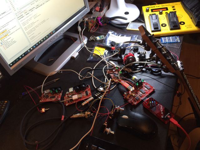

I still got some additional software to write, but the hardware works ok!!!
Any input appreciated, as always.

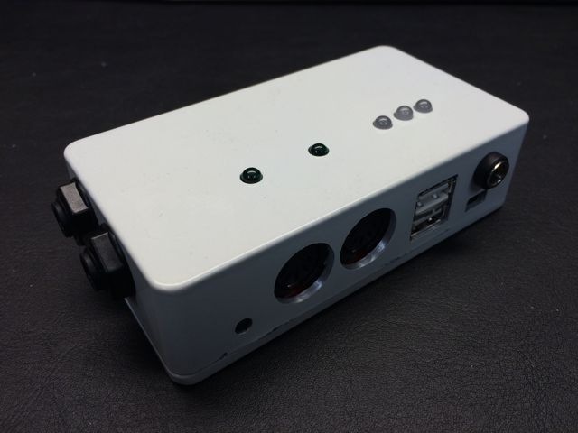

I'm really looking forward to complete the software. However The War Department dictates a house repaint very soon :P

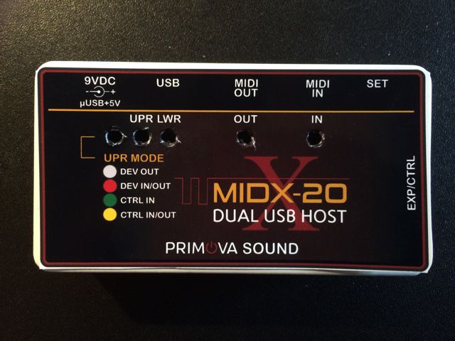

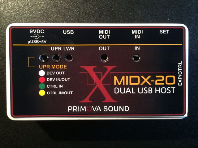

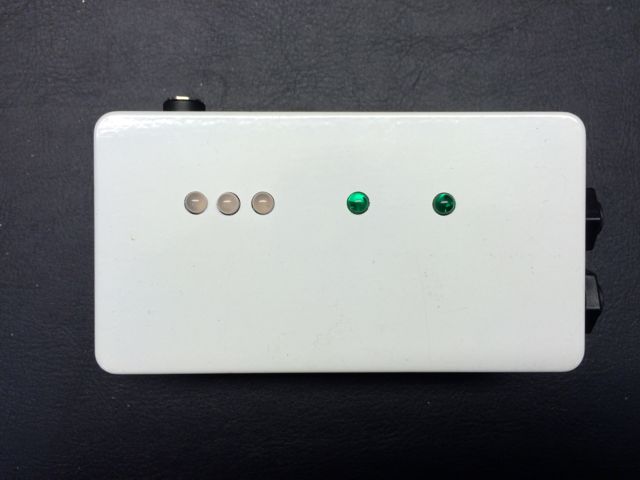

The unit may look like this (same small enclosure as MIDX-10), colorful and nice or just painfully ugly. Hm...not sure yet.
(if you have better artistic ideas, please let me know)
* The unit has two Roland compatible (& Standard) USB Host microcontrollers booting at no time and a EEPROM for storing your settings.
* The two controllers intercommunicate at a speed 10 times faster than regular MIDI traffic allowing instant processing of incoming and outgoing USB and 5-pin MIDI.
* The second (upper) USB connector can be configured in various ways to allow direct USB connection to a USB foot controller or a second synth unit.
* Two Roland EV-5 / FS-6 / FS-7 compatible stereo jacks make it possible to add controls to your synth device via assigns.
* The 5-pin MIDI connectors has an optional THRU mode for MIDI Merge.

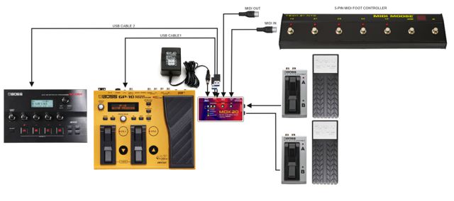

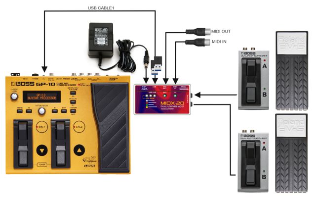

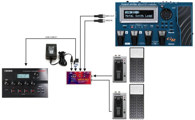

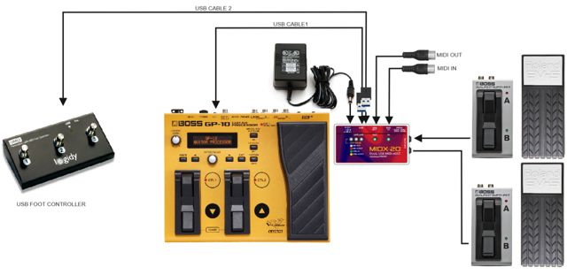

The following images shows some scenarios that will be possible with the MIDX-20.
(I hope you find the possibilities interesting for a future pedal board)
Two Roland USB devices controlled by a MIDI controller and/or Roland EV-5/FS-6/7
Just a GP-10 with more control
A GT-001 and GR-55 with more external controls and in-between connection
A Roland unit controlled by a USB MIDI foot Control + optional EV-5 and/or FS-6/7

From left: Almost hidden button for programming the unit (it can be pressed by a finger but cannot be pressed unintentionally),
MIDI IN, MIDI OUT, 2xUSB and DC Power (Standard 9Volts 2.1mm jack and (5V) Micro USB)....And yes, I'ts pretty ugly drilled and filed but it IS a prototype  ;)
Here you see the two jacks for expression pedal Roland EV-5 or Dual switches FS-6/FS-7. They will be polled rapidly and will generate MIDI CC# for Assigns in the synth units.
The LEDS will be used to show USB status, MIDI traffic and operating modes and will also assist when programming the unit using the 'magic' push button.
The internal stuff. It's a bit crowded when closing the box but fits as planned. The two processors shares the same software but will identify which one they are at startup by checking surrounding hardware. The primary processor reads the expression jacks, operates 5-pin MIDI and has an external EEPROM for storing the setup, while the secondary has a more relaxed life. Each of the processors is connected to their own USB connector. The flow of MIDI data between the two USB connectors, 5-Pin MIDI jacks and internally generated CC# commands is determined by the operating mode selected by the user.

Worked Non-stop from 10:00 - 03:00 today (15 hours, luckily I had a few beers to keep going).
Really manage to get a whole lotta MIDX-20 firmware done today.
- Both USB ports with a GP-10 plugged in works with the Gummie GP-10 floorboard (this proves bidirectional SysEx works etc.) without buffer overflows.
- MIDI Merge is toggled with the push button (single clicks).
- MIDX four different operation modes is selected by pressing one 'looong' time on the push button.
- Four-step Setup Wizard for the two Stereo Control Jacks by quickly pressing 5 times or more on the push button.
  The Wizard allows to setup individual MIDI channel (1-16) and CC# (1-8 banks) for each stereo jack using the push button and the LEDS as user interface, works ok.
  The 8 CC# banks are:
  1 - If EV-5 connected it will transmitt on CC#01, if dual footswitch FS-6/FS-7 it will transmitt on CC#02 & #03
  2 - If EV-5 connected it will transmitt on CC#05, if dual footswitch FS-6/FS-7 it will transmitt on CC#06 & #07
  3 - If EV-5 connected it will transmitt on CC#10, if dual footswitch FS-6/FS-7 it will transmitt on CC#11 & #12
  4 - If EV-5 connected it will transmitt on CC#70, if dual footswitch FS-6/FS-7 it will transmitt on CC#71 & #72
  5 - If EV-5 connected it will transmitt on CC#75, if dual footswitch FS-6/FS-7 it will transmitt on CC#76 & #77
  6 - If EV-5 connected it will transmitt on CC#80, if dual footswitch FS-6/FS-7 it will transmitt on  CC#81 & #82
  7 - If EV-5 connected it will transmitt on CC#85, if dual footswitch FS-6/FS-7 it will transmitt on CC#86 & #87
  8 - If EV-5 connected it will transmitt on CC#90, if dual footswitch FS-6/FS-7 it will transmitt on CC#91 & #92
- The MIDI commands generated by the CTRL jacks are available in all three nodes (2x USB and 5-pin MIDI).
- Merge code is completely rewritten using my new circular MIDI buffers with MIDI parsing both in the
  head and tail to cover all syncronisation and problem fixing scenarios. There are actually 12 MIDI buffers
  running in parallel to controll the flow and merging in real-time to make all MIDX modes possible.
- Inter-processor serial communication at 10 times normal MIDI speed works great.
Got to test the remaining modes and figure out a few remaining things but this looks really promising.
Also got to re-write the bootloader so both controllers can be updated from a PC (via MIDI).
The share the same code so they will flash in parallel as new hex code is given to them.

Enclosures milled and handed over to painting guy for white paint.
Next stop printing and clear coat.

Ok, the painting guy has painted the units white so I made an attempt to produce a print with whatever capabilities I have following the 'touch' of the GKFX-21.
(I have no clue what the X stands for but a 'M' for MIDI looked way uncool)
This is the print me and Misses concluded:
OPTION A:
However and option occurred which is also nice but I little bit crowded.
We though that the upper was better. Your people agree?  A or B?
(I'm planning to hand over the stuff for production tomorrow).
OPTION B:
But I got more gear than I need...and I like it!
I like option B:
The X aligns with the 2 leds nicely.  :)
Yohanes
Option B, but please remove the "X". You can arrange the "MIDX-20 Dual USB Host" logo in the middle of blank space for balanced appearance.
Keep it Simple.
(Pardon me if sound too directive).

Quote from: GuitarBuilder on June 01, 2016, 06:18:41 AM
I'm afraid I was a bigger fan of the yellow, Robert!  I still love the way it matches the GP-10....... :-\
No way, I'm feed up with yellow...
A) Is still kind of nice. According to a me and a guy at EHX.
Quote from: Yohanes on May 31, 2016, 10:43:47 PM
Option B, but please remove the "X". You can arrange the "MIDX-20 Dual USB Host" logo in the middle of blank space for balanced appearance. Keep it Simple.
Yohanes - I quote a fellow Swede: How can less be more, more is always more!!!
However this is option B a' la' Yohanes:
It's very uncomfortable my wife also like this...
C) And then with 'M' as in MIDI...
