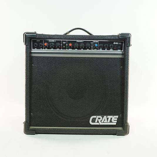

- Having long ago realized that sound via my crate 40xl sucks, I found the output settings, I set this to JC-120 input, and had an OK sound, I wonder what should I set this for playing via various amps on the rehearsals, tube amps, transistor amps, modeling amps, etc.
- for the upcoming live show, I wonder what the settings should be. Should I bypass any amp and go straight for the PA or console ? What do you guys do?

Quote from: panixgr on December 01, 2023, 09:55:04 PM- Having long ago realized that sound via my crate 40xl sucks, I found the output settings, I set this to JC-120 input, and had an OK sound, I wonder what should I set this for playing via various amps on the rehearsals, tube amps, transistor amps, modeling amps, etc.
I never heard of that amp before, but I think I readed it is a keyboard amp, so in that case, I think you chosed the right optput option. Maybe you should try to disable the cab simulation as well on the GX.
I think I would rather buy an "insert cable" and use any of the "return" ouptput options on the GX-100 or just the line/headphones ones. It is possible that the insert on the Crate 40xl doesn´t work if there is nothing connected to the input, but if it does, the amp will only work as a power amp, with no preamp and EQ. Also here try to disable the Cab simulation on your GX when connected this way. If the system doesn´t cover all frequencies, is probably better not to use the cab simulation. Your ears should guide you ;)

Quote from: 802.11Guitar on December 02, 2023, 05:17:19 AMI never heard of that amp before, but I think I readed it is a keyboard amp, so in that case, I think you chosed the right optput option. Maybe you should try to disable the cab simulation as well on the GX.
Crate made GUITAR amps!
What's an "insert cable"? The "return" output options ALL suck with my crate. It has to be "input" I guess.

One aspect of DSP Guitar Amp/Guitar cab IR simulation gear is they are designed to work best directly feeding a quality Full range PA System or recording desk.
Many guitarists with  existing guitar amps of varying quality, assume the new DSP Amp Sim/FX floor unit will be a perfect accessory for their existing budget guitar amp with non flat response speaker , and wonder why its a battle to achieve great guitar tones
Review this important thread to understand why.
100% applies to GX-100
Amplification recommendations for DSP Guitar Modeling systems
https://www.vguitarforums.com/smf/index.php?topic=230.0
Review the Crate GX40XL circuit
The "INSERT" Jack on the front is a TRS (Tip Send, Ring Return) signal flow access point after the internal front preamp stage.
But on the far right on the front control panel is a LINE INPUT
The LINE INPUT  Jack will yeild the most direct uncolored connection to the Crate Power amp. And this is where the Boss GX-100 Mono Output should be connected to your amp LINE INPUT  for best results
Use a GUITAR Cable to connect your GX-100, start with stock Line Output mode , then try other GX-100 Output modes to find the one that works best for your style and guitar type
Always edit GX-100 presets at the same volume you will be performing live at gig with your drummer.
Reduce the bass to prevent cheap speaker flub and stay clear from your Bass Players low frequency range

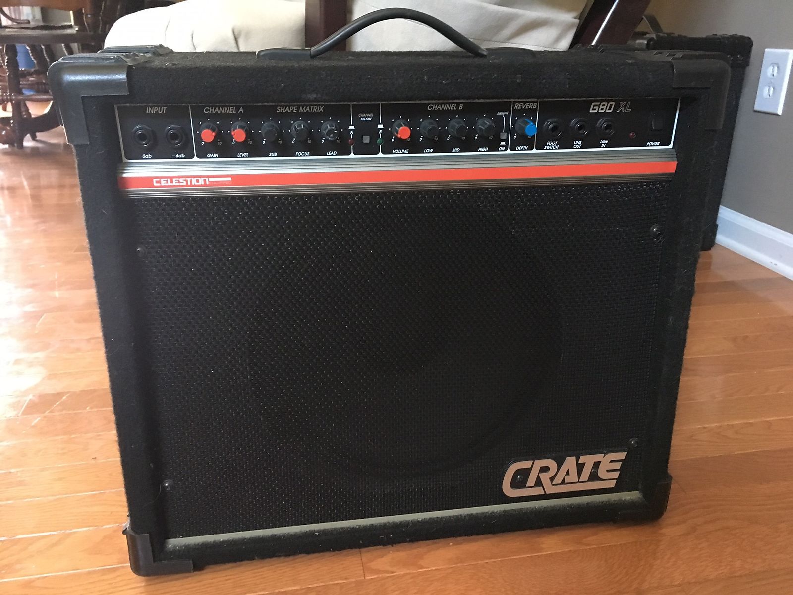

I look at the back of my crate, no LINE IN.
802.11Guitar
Sorry, the manual I found was for the G40CXL (which has insert and it for keyboard if I'm not wrong) instead of G40XL
https://www.manualslib.com/manual/33086/Crate-G40cxl.html
I think you can use the Line In on the front and just disable the Cab in the GX-100
