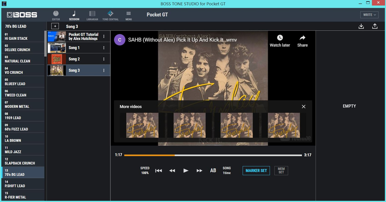

I got a gently used Boss Pocket GT ($115) - and I must say this is already a good sounding and versatile tool
While some youtube content refuses to run in the Boss Tone Studio for Pocket Studio Session manager  - many vids do play and the built in transport keys work on my tested Windows 8.1 and Android 12 devices.
