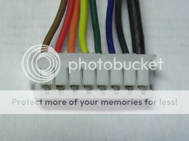

Got my FTP 4 days ago and I have to say it's fantastic. besides a few gripes with the mounting (doesn't fit on my strat with any of the brackets and can't fit on any of my LP's due to the pickup ring which I believe is a pretty common issue).
Anyway besides the above it is truly revolutionary so I immediately ordered a second and started tinkering with this because I really don't like mounting mechanism.  I have 3 guitars with Graphtech piezo's and preamps.
At first I hooked the piezo's directly to the triple play circuit, the results: the signal on the 2 bass strings was too weak. It still worked but even with the sensitivity all the way up to 16, the bar would only go about 40%, this didn't seem acceptable.
So next I hooked it via the 13 pin jack using a battery to power the pre-amp, results: Signal was now too high, I turned down sensitivities to 1 and still everything was getting in the red. As a last resort before giving up I switched the Traktion Switch (on the graphtech 13 pin jack) to the axon position, this seemed to cut the output a bit and bring everything more into range.
So far it seems pretty usable. I haven't done a side by side comparison, when I get the second unit in a few days I'll put both on the same guitar and see how they compare. Ideally if it ends up working , it would be really useful so I can easily switch the same unit between any of the guitars without any mounting etc.
Just thought I'd post this in case anyone else has been trying some mods.

the tracking seems as good as with the original pickup (not really much room to improve but not had enough time to really test properly) but since the signal from the piezo's is either too weak (without the pre-amp, something to do with impedance but I don't really know the electronics stuff ) or a bit too strong with the preamp(it doesn't over load but at very soft picks it is still above 50%) I'm concerned about the dynamic range, I think that the difference between the loudest and softest notes with the piezo is more restricted.
I'm hoping to get my second unit and plug this to the 13 pin jack and also mount the pickup and compare the midi from the exact same playing. I'll be happy if It's 90% as good as with the original pickup as thats still 1000% better than any of the previous midi solutions I've tried and it can be easily moved.

I think unlike many others I'm not too interested in both systems working simultaneously (a little over my electronic skills). I would be happy if the FTP worked with my guitars with 13 pin internal installations (I'd mount the FTP on a strap).Right now, I don't know if the battery that's driving the hexpander pre-amp is interfering with the FTP but it seems to work *Almost* as well as with the FTP mag pickup. could it screw up the FTP battery or controller?
The issue is too many accidental note triggers from the low E and A strings .(it's still miles ahead of the GR-55 and Axon in terms of usability, If I hadn't experienced the proper FTP performance I would be happy with it).
I would ideally like to lower the output of the 6 pins to the FTP so I can reduce it from there and then set the FTP sensitivities to midrange rather than all the way down as present.
I picked up 6 10K trimpots (hard to find where I live, had to dig through 5 trashbins of various misc components.). If I get a chance today evening I'll try and rig it up and see if it's an improvement. I also got my second FTP today so I can mount both systems on the same guitar and record the same part to different tracks and compare. I don't think it's will improve on the original's performance as I think a lot of brainpower went into optimizing with the mag output which is probably why even the Godin Session Custom doesn't use piezo's.

Ok so rigged up all 6 trimpots (it aint pretty but it functions correctly, pic attached). So one triple play via 13 pin with battery and trimpots and second triple play directly on same guitar. Verdict: Can't seem to get the same performance from the piezo path.It's 90% there but still missing something.
All the sensitivities are in the right range (I have the FTP app set to midrange for all the strings). False notes are now in control but I think it's the release and the dynamics that is just much better with the original magnetic pickup. It's that final 10% that really makes me forget I'm playing synth. It's like the volume curve matches the acoustics of unamplified guitar much more closely when using the original setup
Anyway I'm kinda out of ideas of how to improve this any further as I'm sure there's ways I could mess with the frequency curve to approximate the magnetic (which I assume is optimal), but now I'm leaning in another direction.
I'm thinking to mount magnetic pickups on the 3 guitars and have a common output to the FTP controller. Since I'd mount the controller on the strap I think that the issues with interference and cable length should be minimized.
