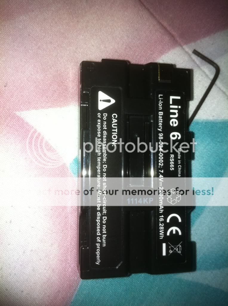

BTW - the JTV Li-ION Battery appears to be identical to a Sony NP-F570

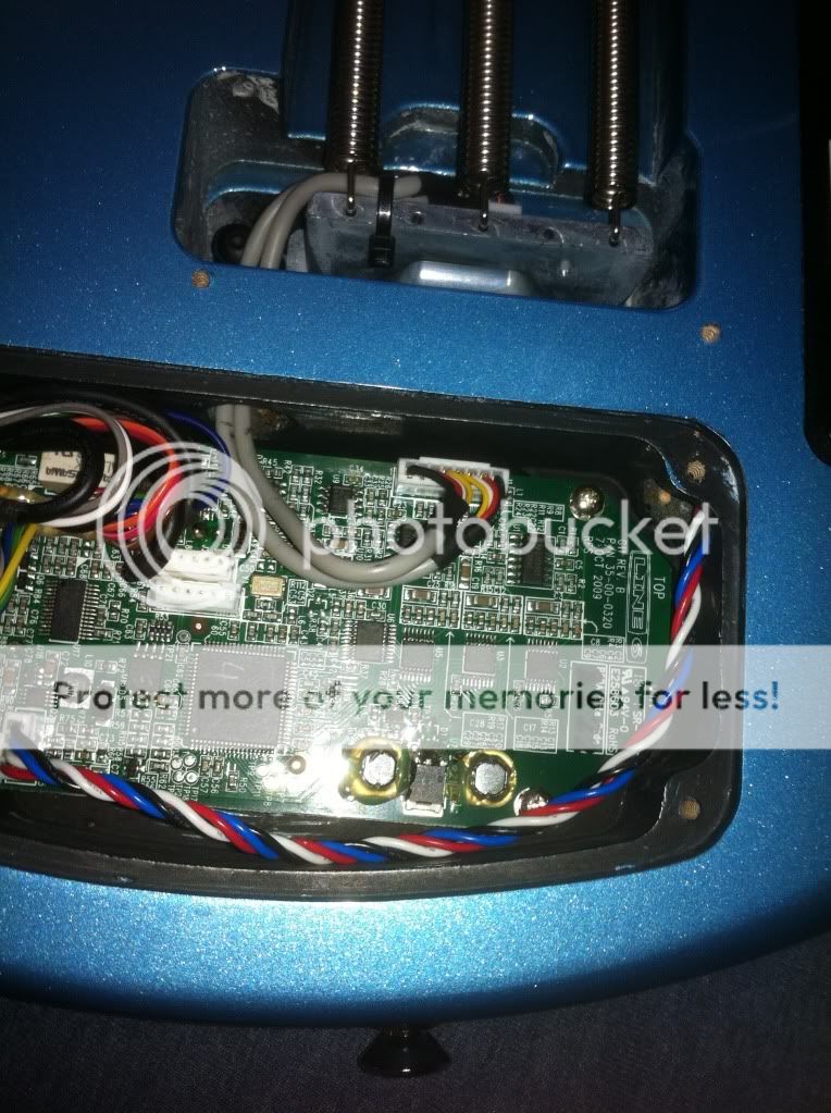

My Guitar has now been returned to me from Line6 repair.
First I want to thank everyone who worked on my JTV-69 at Line 6!
This guitar is wonderful now!
It now plays very well, and the tremolo reacts to my subtle touch and aggressive dive bombs and stays in tune  - just as I always wanted it to be!
This is what they did:
Repair Details: Root cause of failure
Bridge post prevented bridge from returning to pitch.
Technicians notes:
- replaced nut
- high E-string had a buzz and 2nd tone due to the slot in the nut not being cut correctly
- did setup on the guitar and verified the problem
- changed the cable tie on the piezo cable to the new suggested part
- retested and found that depressing the bar and releasing it, the bridge would return to pitch, however pulling back on the arm and  releasing it, the bridge would remain sharp in pitch.
- removed bridge and verified that the tremolo arm nut was rubbing on the body (routing)
