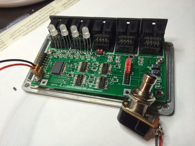

Hi there, with a 20-pin microcontroller and a handful components a smarter Roland GKP-4 clone could be made.
As this is a parallel box (not a switcher) GK sound is echoed from GK IN to to all GK A,B,C,D outputs all the time.
The Roland GKP-4 has eight hardware switches to control all the S1/S2 and VOL permutations.
- Switches are expensive
- You have to bend down to toggle them.
- Mounting,drilling,wiring is costly etc.

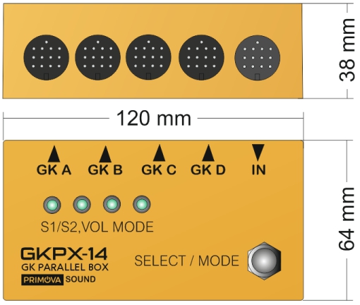

Instead with just one single foot switch and four double-colored LED's  (GREEN+RED component) the following could be realised:
- When started Guitar VOL is sent to all outputs. S1/S2 switches are sent to GK A. GK A LED is flashing, thats the Cursor.
- When stomping the switch the Cursor cycles through GKB, GKC, GKD and back to GKA etc. shown by flashing LED.
- When Double-Stomping, the GK at Cursor position is toggling the S1/S2 mode. Indicated by RED light ON/OFF.
- When Holding Down the footswitch a short while, the GK at cursor position is toggling the VOL mode shown be GREEN  color ON/OFF.
Notes:
- VOL is either Guitar VOL setting or MAX setting.
- If both RED and GREEN components of LED is lit, the light will be yellowish.
- If both S1/S2 and VOL is OFF the cursor is indicated with a short flash-ON
- If any of S1/S2 and VOL is ON the cursor is indicated with a short flash-OFF
So, do you think it's worth doing? I estimate a sales price around $140 USD

foot print 4.7" x 2.5" (120mm x 64mm) replacing a GKP-4 no longer sold with as few mechanical components as possible.

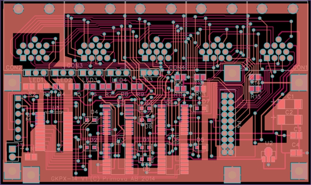

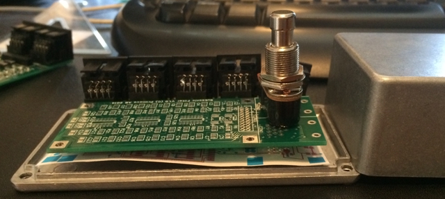

Spent some hours with the PCB for this tiny enclosure today
(sniked away from the boring job of refurbishing the basement for my
upcoming work/music room) and I think I managed to squeeze in
a socket for my subsonic filter in case/if/when it turns out ok. So it looks
it might be possible to have that as an option within this 4.7x2.5 inch
1x4 GKP-4 clone.
Biggest problem is my vacation ends today....less number of quality hours.
But I got more gear than I need...and I like it!
CodeSmart
So now's the question, is there a possible need for a teeny-weeny little microcontrolled GKP-4, should I produce a handful units?
Well, the board is designed...
and it seams to fit...
and also with an optional Subsonic Filter board on top...
...it does seem very brutal to stop now, doesn't it?   ;D

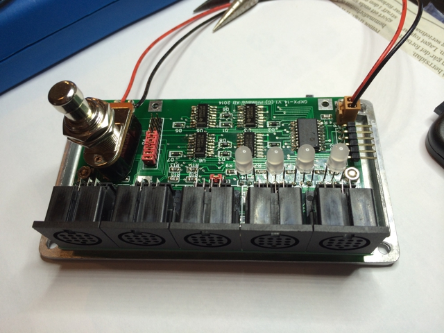

And now today I got my boards and assembled my first miniature microcontroller based "1-button" version of GKP-4 / 2xUS-20.
I haven't got much to show until I do some programming, so meanwhile enjoy drJoness video of his product.
(Must be great for you other guys just playing guitar or something, while we do the hard work for you  ;)
We both spend lot's of time and some investment to do these things so I hope we both sell a handfull.
I'll put up a video as soon as I can get the controller running, assuming the board works.

CodeSmart
Quote from: billbax on August 25, 2014, 09:24:55 AM
Your GKP4 clone looks very nice and compact.
It's compact because the microcontroller controls every switch setting in software. My board may also host a second board (subsonic filter), but it's veeeery tight in there. Also I don't know if there will be noise radiating from the controller. In that case I'm dead meat.
Unfortunately my programmer was not compatible with the device I elected for this board so I've given up right now. Have to order a new better programmer/burner. More $$$... :P
CodeSmart

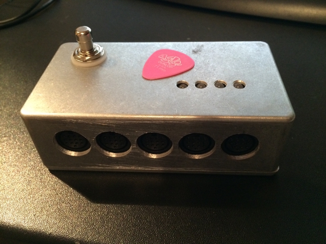

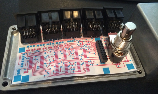

Well, had a play with the drill to make the first rough enclosure.
The two-colored LED's will be prolonged to stick out 2 mm. Holes are 0.5 mm wider than required to cope with two layers of paint.
The soft "no-click" foot switch is easy to operate and will allow you to program:
- What unit(s) to be muted (US-40 mode) or kept at full volume (GKP-4 mode) while the other unit(s) are controlled by the guitar volume knob.
- What unit(s) getting the guitar S1/S2 commands.
The unit can also host an optional GKFX-11 Subsonic Filter if you have piezo instruments. In that case the foot switch will have to stick out a little bit more.
The pedal is powered by Unit A and contains protection diodes for the other units.
Unit B,C,D draws a small amount of current so GR/VG/GP can detect the presence of GK input.
Waiting desperately for the new programmer to arrive so I can start downloading C-code into this tiny little thing.
My hesitations right now:
- Will the microcontroller work, and is it accessible from the PC using PICKit3 connected to the six pin connector of the board?

Quote- Even if board is designed with very much ground shields, will the microcontroller radiate audible noise located so close to analog circuitry and connectors?
You must employ separate "Analog Ground" for Op amps and GK13 jacks  and separate "Digital Ground" for CPU. - and then tie them together at one location for a "star ground" arrangement.
Some will employ  a 10 ohm resistor between AGND and DGND, to decouple any RF Current noise that is rampant in the Digital Ground from the Analog Ground
CodeSmart
Quote from: Elantric on August 26, 2014, 02:51:08 PM
Completed the coding. Learnt a whole lot. Even got the in-circuit debugger working. The PCB works great from a logical standpoint but yes, as I was afraid of it's noisy  :(
I got myself into a not so trivial topic. The computer itself induces audible background digital noise as it executes instructions and the current inrush when flashing LED's on/off causes "clicks" to the hex audio lines. My idea is now to cut some traces on the board, rewire digital ground and see if it cures the problem. Will also test with external power to the digital circuitry for comparison. Also may need more/different capacitors and inductive filters.
Not as easy as I imagined adding a computer powered by the 13-pin connector, but yet very interesting...
