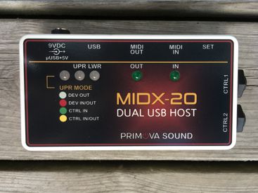

I'd ask for more options for boss multifx units to be able to control the katana via midi or usb. The GA FC is fairly limited compared to what could potentially be achieved with control from the multifx units. I would suggest it makes good commercial sense to do this, and is common in av equipment where manufactures know tight integration between products sells more boxes ! Other manufacturers are going to struggle to offer anything to compete.
Quote from: sikejsudjek on May 25, 2017, 01:11:40 AM
Until then, there exists this alternative option that enables  more Katana control via MIDI
Just add FCB-1010 or KMI SoftStep2, or your favorite MIDI floor controller
PRIMOVA MIDX-20 Dual Roland USB MIDI Converter / Ctrl Interface
https://www.vguitarforums.com/smf/index.php?topic=17561.msg125048#msg125048
http://www.primovasound.com/midx_20.html
MIDX-20 owners manual
http://www.primovasound.com/pdf/MIDX20_Manual.pdf
MIDX-20 NEW V1.4 Firmware with BOSS Katana MIDI Bridge (+Sneaky Amps).
(Need PC Assistant V1.1 from web page to flash the upgrade, Previous Assistant V1.0 will not flash properly)
MIDX-20 Katana MIDI Bridge document updated:
http://www.primovasound.com/pdf/MIDX_20_Katana.pdf
CodeSmart
With upcoming MIDX-20 V2 firmware (free upgrade) you also get all Katana 'new' sneaky effects, Boost and Mod at the same time, Delay and FX at the same time, all accessible using CC# from your foot controller.
MIDX-20 Comparison chart / Feature list
https://www.vguitarforums.com/smf/index.php?topic=17561.msg151641#msg151641
Documentation/manuals and a new batch of MIDX-20 units is in production now.
Also in MIDX-20 V2 there's MIDI filtering, virtual channels, dual channel broadcasts, CC expression curve mods, tip-heel inversion, CC/channel translation/duplication, momentary to toggling conversions and more.
